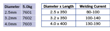

    2.5 mm x 350 mm   5kg pack

    Current Type: AC/DC-
    Arc Voltage: 50V
